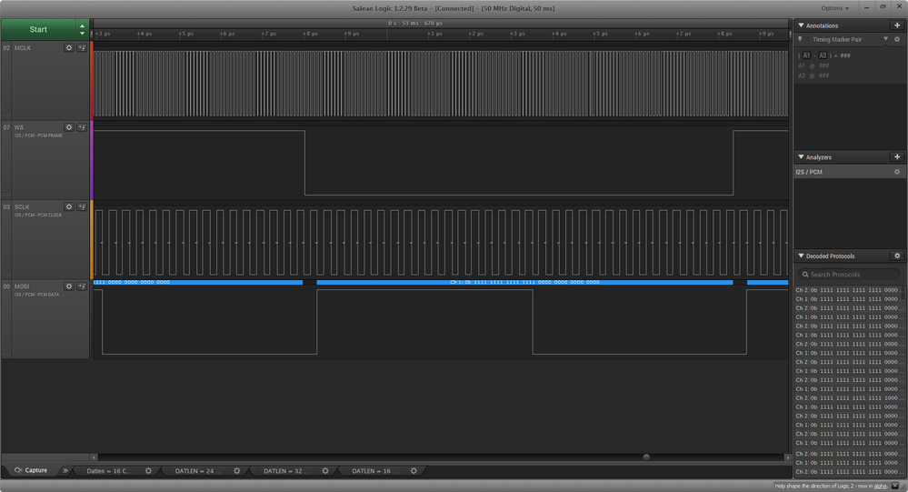

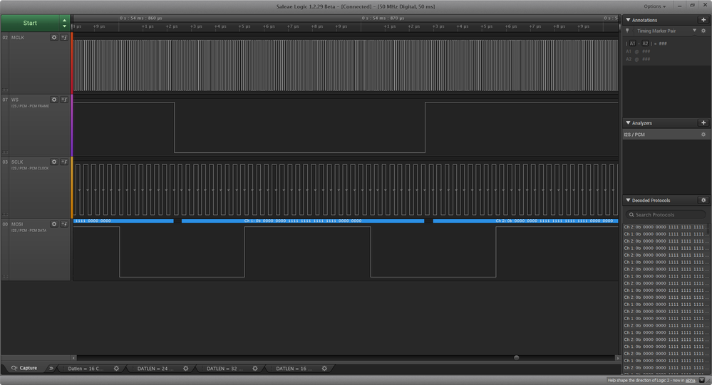

2020-12-05 2:53 PM
Noted, will do the code clean up in a later time. Thank you for the advice. I got it working, however I finding weird things on the I2S bus
Sending 0xFF (16 bits) with DATLEN = 16 and CHLEN = 32, works perfect. Starts after 1 SCLK, after 16 bits the left over 16 bits are set to 0 due to CHLEN > DATLEN. Its also MSB.
Sending 0xFFFFFF (24 bits). Whats going on here? It looks like I am missing a byte in the beginning? DATLEN = 24 CHLEN = 32,
