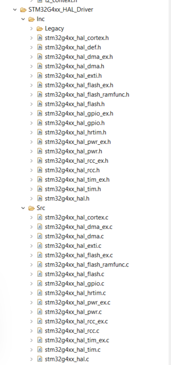

Hi there, I have been using STM32G474, but if I look into the HAL driver folder structure I cannot find the files for LL-Drivers. I want to use LL functions in my code.
Looking forward to your quick suggestions.

In the internal structure of your project you cannot find the LL libraries because you have generated the project with CubeMX by setting to use the HAL libraries.
You have to manually include the LL libraries which you can find in the STM32Cube repository on your computer.

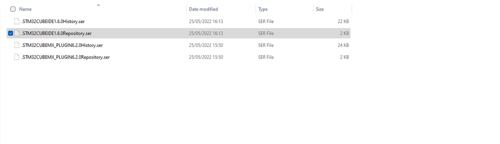

@Andrea Canepa I tried to follow your path but the thing is inside of "stmcube" folder, I could only see these files with the strange extensions
2022-05-25 7:42 AM
I don't know why you don't have the libraries in the standard location, but you can use the files you downloaded from GitHub. You just have to place them in a different folder to prevent them from being deleted during the code generation by CubeMX.
