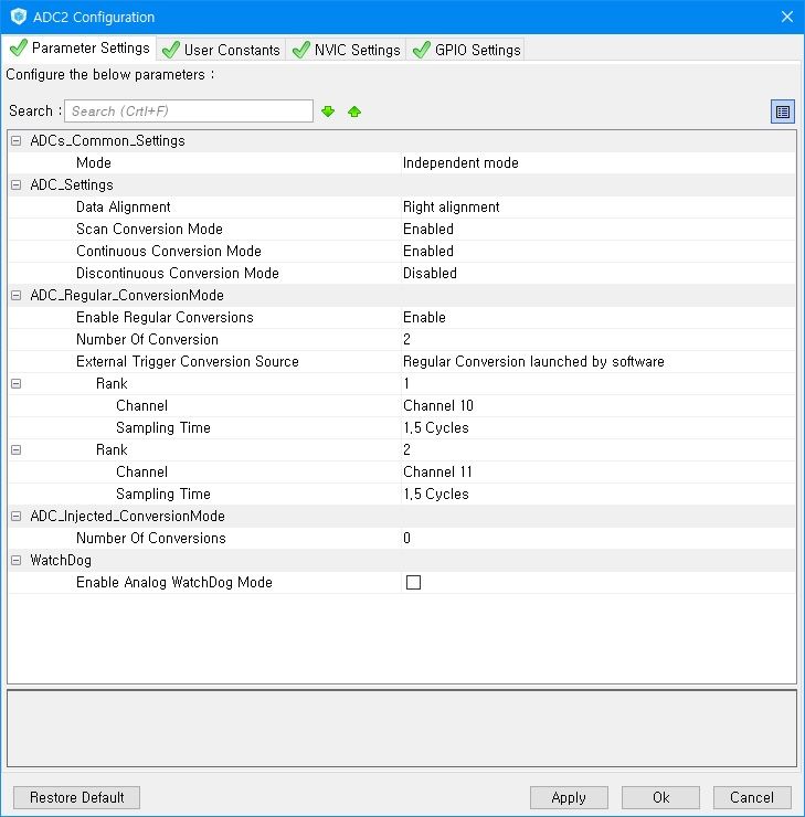

I am trying to get two voltages using two channels with one ADC block.
My MUC is STM32F103RB. The followings are configruation of ADC and my program code.

Since the 3.3V line was connected to #1 and #2 was not connected, I expected the values of #1 to be about 4000 and #2 to be about 2800.
However, the actual result is either the values of # 1 and # 2 appear to be opposite to each other, or they represent the same value.
I'd like to know what I should do.
2018-09-11 7:59 PM
You should use DMA to place into an array, then use the DMA HT or TC in place of the ADC EOC
2018-09-11 11:00 PM
My program has several tasks based on FreeRTOS(9.0.0) and CMSIS(1.02). After start the ADC using HAL_ADC_Start_DMA(), other tasks are not worked. Should any other functions be used?
