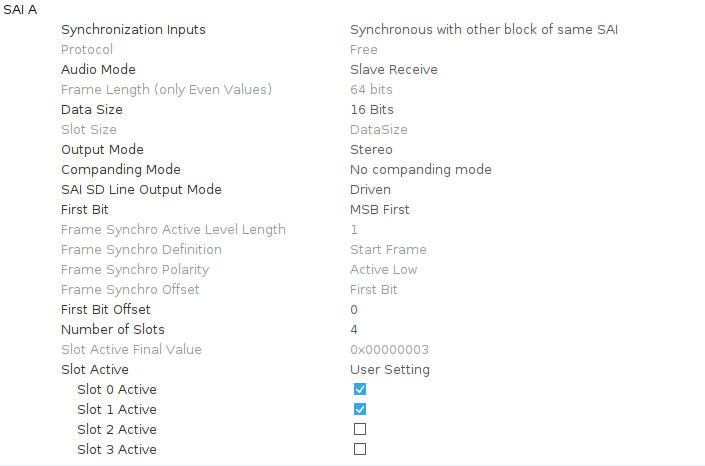

What I want to do is get an audio wave from line_in (the blue audio jack on the board).
The setup for SAI1 is in the picture, I can play the audio through the line out without any problem but can not get the readable waveform data from the line in.

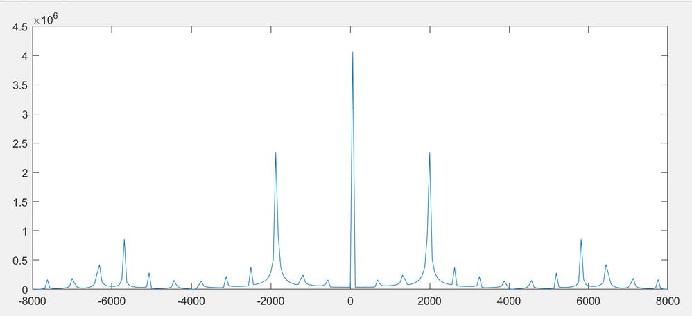

}The audio input is a 2k sin waveform, what I got from SAI1 are:
It does have the 2k frequency peak, but the waveform is far from a sin wave, what could be the problem?

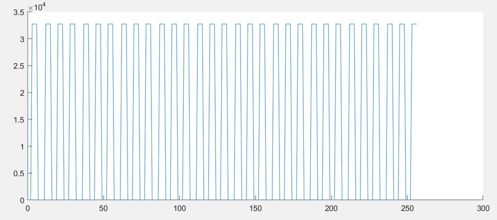

2022-03-22 5:33 PM
It seems something happened with the first bit of some data. The received values are something like ...,32761,32765,3,8,13,... which should be ...,-7 (32761-32768), -3 (32765 - 32768), 3, 8, 13,...
Even if I modify the value manually, the value seems to be too small, the amplitude is less than 30.

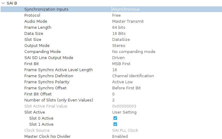

Finally, I managed to make it right, the Frame Synchro Offset of SAI-A didn't match the SAI-B's settings. It should be 'Before First Bit'.
And the amplitude problem is caused by the input volume of wm8994.
