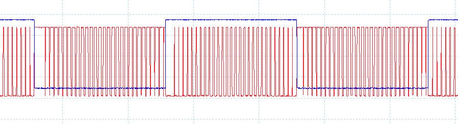

Now i also want to generate SQUARE wave from channel2 , the wave should have time period of DMA length.
so lets say DMA(sPWM) contains 100 elements , channel2 should generate square wave,
which is HIGH for first 50 elements and LOW for last 50 elements of DMA(of sPWM)(see Picture attatched).
