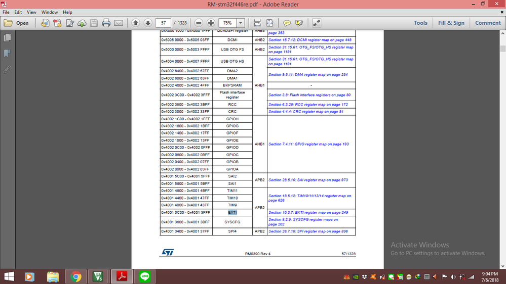

Sorry for my stupid question, but this makes me really confused. I was just looking for the the bus with connected with the EXTI, then I found that APB2 bus is connected as it is shown in the reference manual in here :
https://www.st.com/content/ccc/resource/technical/document/reference_manual/4d/ed/bc/89/b5/70/40/dc/DM00135183.pdf/files/DM00135183.pdf/jcr:content/translations/en.DM00135183.pdf

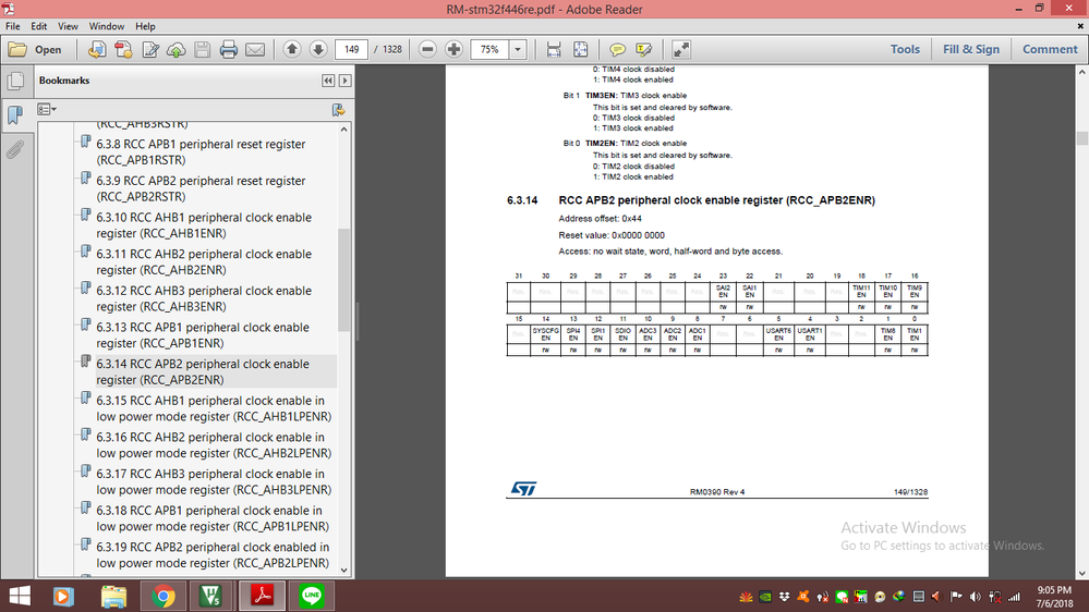

But when I tried to activate the clock for APB2 bus in APB2ENR, I cannot find in what bit is the EXTI in.
Then I got confused in what bus and what bit is it to activate the clock for exti. Sorry for this stupid question, by the way I am a new learner

EXTI clock is always enabled.

Posted on July 07, 2018 at 05:50
So I dont have to enable it with APB2ENR ?
Posted on July 08, 2018 at 00:56
No.
Posted on July 08, 2018 at 05:57
Thank you sir
How can I know whether the peripheral needs to have a clock enabled or not? Where exactly in Reference Manual/Datasheet should I look for this info?
A RCC_AHB2ENR_EXTIEN would be a strong sign that explicit enable is needed. absence of that bit is a stong sign that no explicit  enable is needed. And to my knowledge no other STM32 needs explicit EXTI enable.
On the F1 isn't it part of the AFIO ? Been an age, but definitely a couple of things under the AFIO, perhaps SYSCFG/DBGMCU type stuff, would have to look at RM0008 again.
