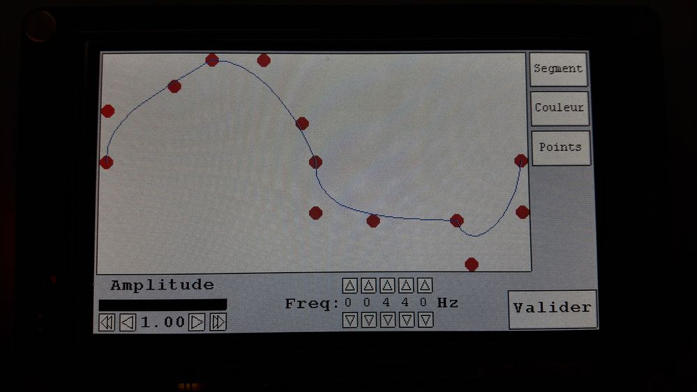

2018-05-18 6:21 AM
thank you both for your help,
First of all i will read all the documentations you talk me about.
I will explain you the entire project.
I make an interface on the stm32f7 where a user can draw a Curve
by moving control points (red points in the picture) of a bezier curve (as you can see in the picture).
Then, thanks to the Bezier equation, I sample the curve at 48kHz and i put the coordinate of the 48 000 samples in two arrays, one for X which represents time and Y which represents voltage.
But now I would like to generate the sound correpsonding to the curve drawny by the user.
Thanks again !
2018-05-22 12:40 AM
For sample output, the 'X coordinate' is implicit.
Then, thanks to the Bezier equation, I sample the curve...
Bezier interpolations are for graphics, not sound. I hope you are aware that such second / third order functions create spectral artifacts in the output.
The only noteworthy point here is to get the user input, and make it into samples. The rest is the same.
Not sure what the real use case is, though.
