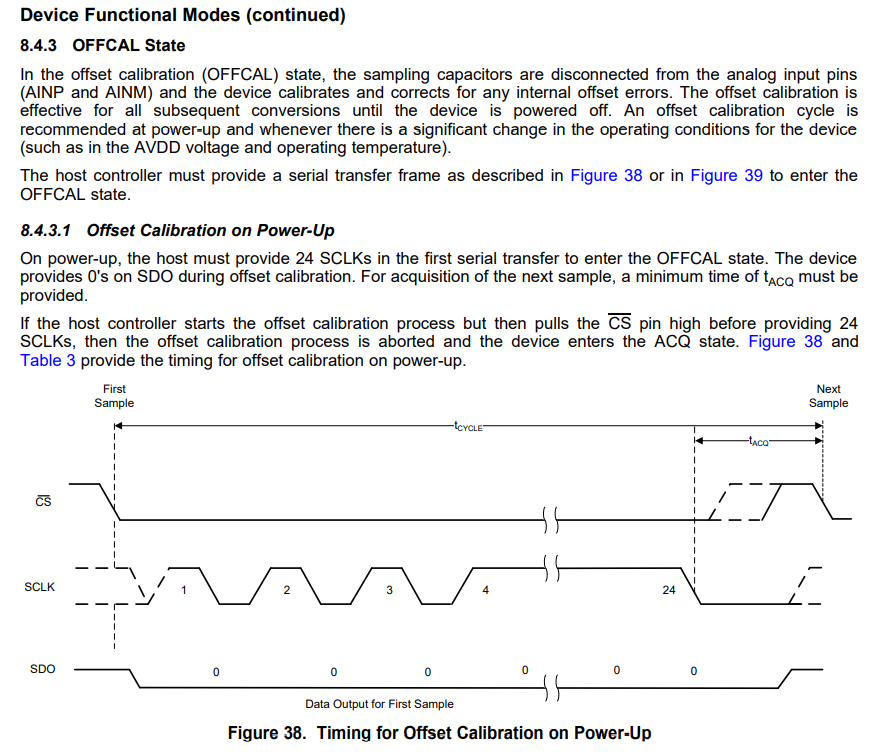

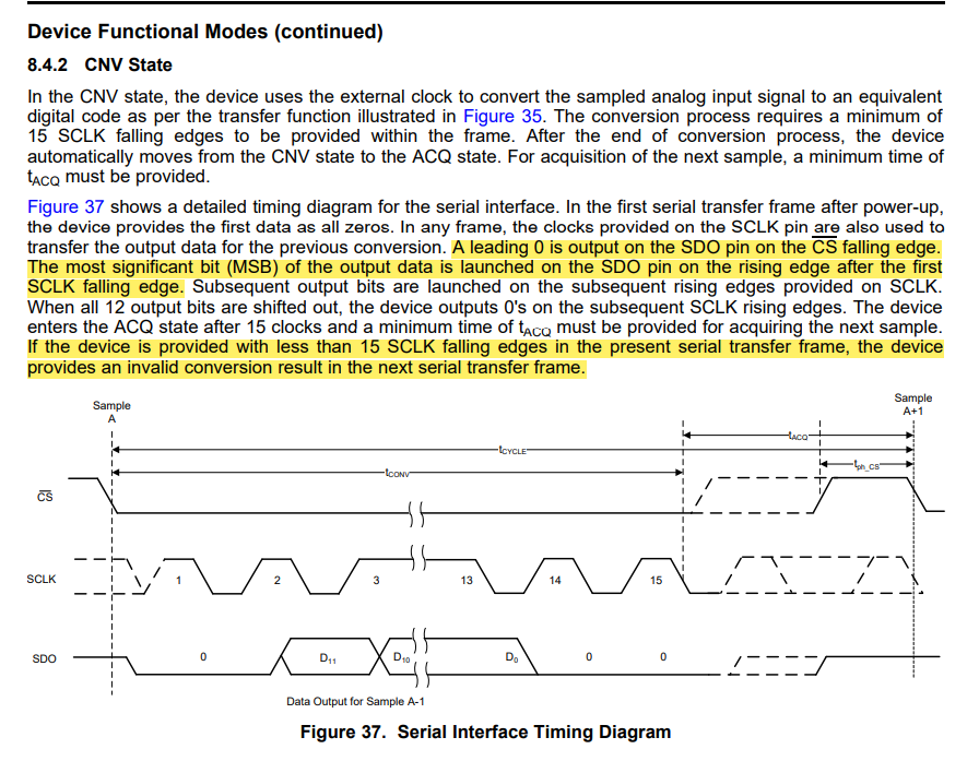

I am working with ADS7046 i need to generate 24 cloacks for calibarration and for data I need the 15 SCLK .Its SPI COnfigurable. So how I can genertare the 24 SCLK and 15 SCLk

Either use 3 8-bit frames (or 2 12-bit frames) and one 15-bit (reprogramming the SPI between transfers) or do it with 3 13-bit frames, shuffling the data in software.

Are these two independent transactions?
24 + 15 = 39
39 / 3 = 13
You could perhaps configure as 13-bit words, and do 3 word transfers.

I am using the STM32h745 series of controller. For calibaration purpose I need 24SCLK and for the data it requires 15 SCLK clock. Its only receiving mode.
In SPI I set the mode Receive only master
Data size I set the 16 bit

How I send the clock pulse 24 for calibration?
I use the only receiving function I need to use the Transmit function for sending dummy data for calibration?

To send 24 clock pulses, just send 3 8-bit frames or 2 12-bit frames. You don't need to configure the MOSI line for that.
From the above docs, it should be done only once after powerup.
