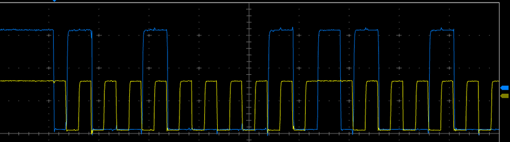

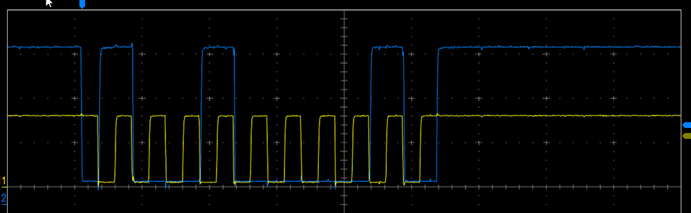

Correct clock streching and read when using HAL_I2C_Master_Receive
Read cancelled by HAL when using HAL_I2C_Master_Receive_IT

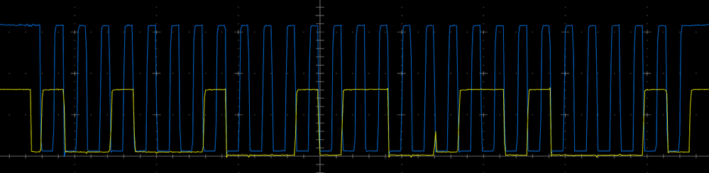

0693W00000aJCj5QAG.pngRead correctly done with HAL_I2C_Master_Receive_IT(but incorrect values reported by device) if I wait for an amount of time that requieres
Any idea how to support clock streching in master mode with Interruptions?

Where is the SCL clock stretching in the scope captures? SCL clock stretching means the yellow clock pusle should have missing pusles if master doesn't hold on. The "Stop/Start" bit makes a longer clock high period, it's normal. I'm puzzled.

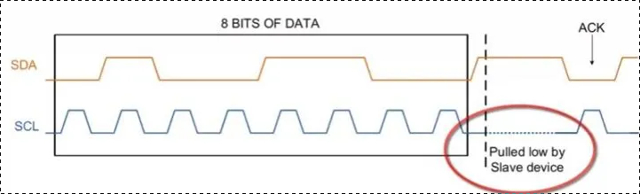

AScha.3
Super User
you didnt show any clock stretching , as S.Ma said.
it would be like this : scl kept low by slave

@AScha.3​  Thank you for the clarification. I was misinterpreting the stop+start as the clock stretching. This means that what I am probably seing is the TX of a message that for some reason i failing and then a second message is started to be TX. I will further troubleshoot this issue
