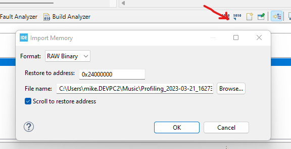

I need to fill certain RAM (buffer) locations with known values (i.e. compressed audio) during a CubeIDE debug session. I thought there was a way to load values into RAM while the program was stopped at a breakpoint. But I can't seem to find this tool. Seems like it existed in Atollic, but can't find it in CubeIDE. Any thoughts?

In the Debugger Console view you can enter a command
restore mydatafile.bin binary 0x20001000to load it to the address specified.

2023-03-25 11:20 AM
Thanks KnarfB Found it.
