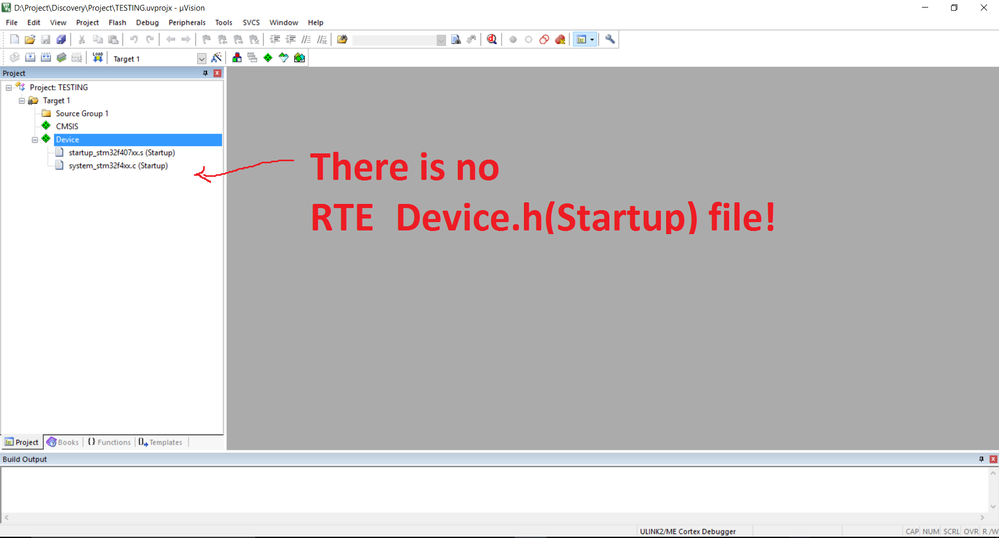

Another question, when I choose vgtx from software packs, it doesn't make inRTE_Device.h(Startup)
my project tree. why it doesn't build this file? I saw in all the youtube tutorials, they have this file under the Device group in project tree but I don't have it! why?2017-09-03 9:25 PM

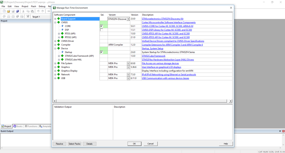

I choose stm32f407vgtx and then CMSIS and Startup options as shown below:
But I have no RTE_Device.h(Starytup) file! file!

I'm not using RTE, I use Keil uv4 and 5 to build SPL and HAL code directly.
Perhaps you can set up the project with an F4 part that generates the file you want, and then go change the target later. As I recall T6 is a package/temperature.
All the F407 parts share a common die, and are tested/marked to create pricing stratification.
