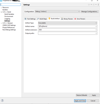

To get .stdlr file, go to project properties
Hope it helps!
foued

Hello @FLuba.1 ,
Hope it helps!
foued
