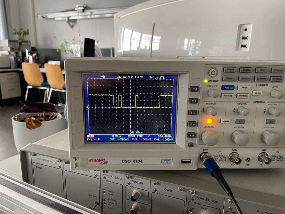

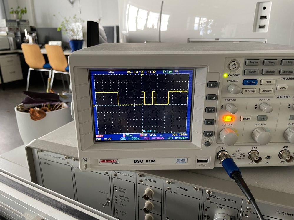

Okay let me show the picture of the scope. Because I am fairly new to UART.
When I send the number 2 as bytes through UART in Simulink:
When I send the number 1024 as bytes through UART in Simulink:

Your oscilloscope can save the screen image to a USB stick:
https://www.manualslib.com/manual/1595629/Voltcraft-Dso-Four-Channel-Series.html?page=64#manual
This will give far better, clearer results than a photograph!

"When I send the number 2 as bytes through UART in Simulink"
Do you know what Simulink actually sends when you do that?
What does a simple terminal show?
Again, Simulink may be giving more confusion than help.
Maybe time to go (back) to basics?

"Do you know what Simulink actually sends when you do that?"
So the input value is set as a uint16, and then with the Byte Pack block in Simulink, it packs the input data into a single output vector type uint8. There are no indications of whether it adds padding or CR/LF.
2022-07-26 6:29 AM
"I know but currently I don't have one at hand."
"it packs the input data into a single output vector type uint8. There are no indications of whether it adds padding or CR/LF"
So you don't know what it's actually supposed to be sending? How, then, can you possibly write code to receive it??
Again, I think you really to go back to basics.
Or, at least, use a terminal to see exactly what it's sending (may need to be one that can display binary; eg, PuTTY)
