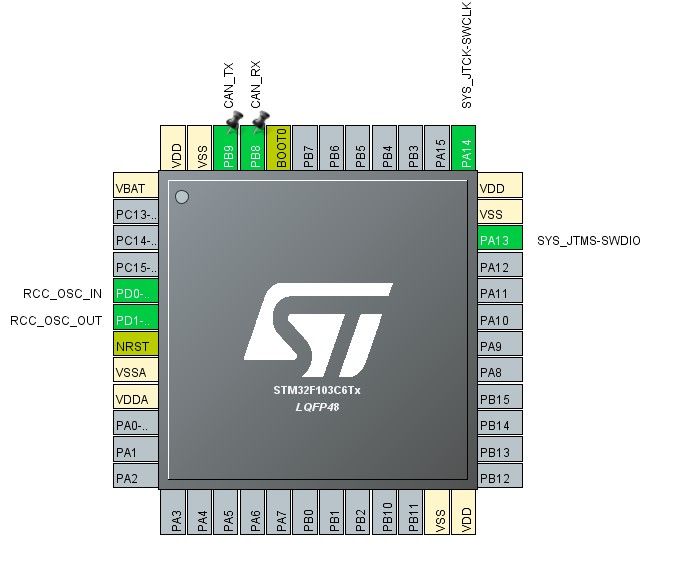

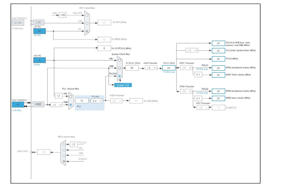

Hi everyone! I use the STM32F103 microcontroller to work with the CAN bus. I work in the Keil v5 environment and use the CMSIS library (I took the source files for my MCU from CubeMX). However, during debug, when I send the first data frame, I get the "Bit dominant Error" error in the CAN_ESR register. For verification, I created a project in CubeMX with the same settings and there I get an "Acknowledgment Error" error (this is a must because the module is not connected to the bus, but this at least means that it sends the frame). All register values in my project (using CMSIS) and the project from CubeMX coincide except for the WKUI bit in the CAN_MSR register (it is not installed in my project, but it is installed in the CubeMX project). I think that in my project the CAN controller does not exit Sleep Mode since an invalid signal is on the Rx pin. However, I don’t understand why everything is normal in the CubeMX project, the values of the registers are identical, maybe I'm missing something? Nzhe settings and sending packages in my project and project from CubeMX
Clocking:
Pin configuration
