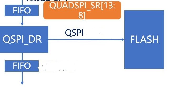

According to my understanding, I can read/write data directly through the "DR" register. Why do I have to set the FIFO Threshold value? How to use the FIFO correctly during the reading and writing procedure?
And another question is that How to set the "CSHT[5:0]" in "DR1" register? For example How to set the "CSHT[5:0]" if I use "IS25LP064A" Flash?

You don't have to set the FIFO level, but it paces/modulates the IRQ or DMA so they are not continually hammered for every byte, and you can stuff a burst of data in a single transaction.
Read the data sheet for the IS25LP064A, tells you the minimum high time for CE# is 7ns, translate that into clock cycles based on how fast you're clocking the interface so as not to violate this.

Tesla DeLorean is correct. FIFO level is a trigger level when you need the interrupt be called. If you set it to 1 byte, it will fire an interrupt every byte. Typically, you would configure that level based on the application. If you know you are going to be transferring images, in say a RGB888 format, then you would set the FIFO to something like 3.
