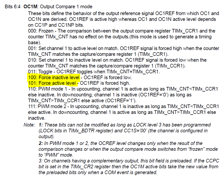

You need to modify the TIMx->CCMRx_OCxM bits to what you want. The pin cannot be controlled directly.
You probably want to use the "force active/inactive level" options.
You could also reinitialize the pin as GPIO and control it that way.

For example, setting CH1 on TIM2 to Force inactive:
TIM2->CCMR1 = (TIM2->CCMR1 & ~TIM_CCMR1_OC1M) | (4 << TIM_CCMR1_OC1M_Pos);JW

But than it's LOW forever. I would like to set it to LOW, so next time it matches TIM2->CNT it becomes active again. "Force inactive" disables the "Active on match". I don't know how I can achieve this. Is there some trigger I have to reset? I did already read through the docs about timer, but I don't know what to look for exactly.
Well, then after you set it to Force inactive, set it again to Active on match.
What's the problem with that?
