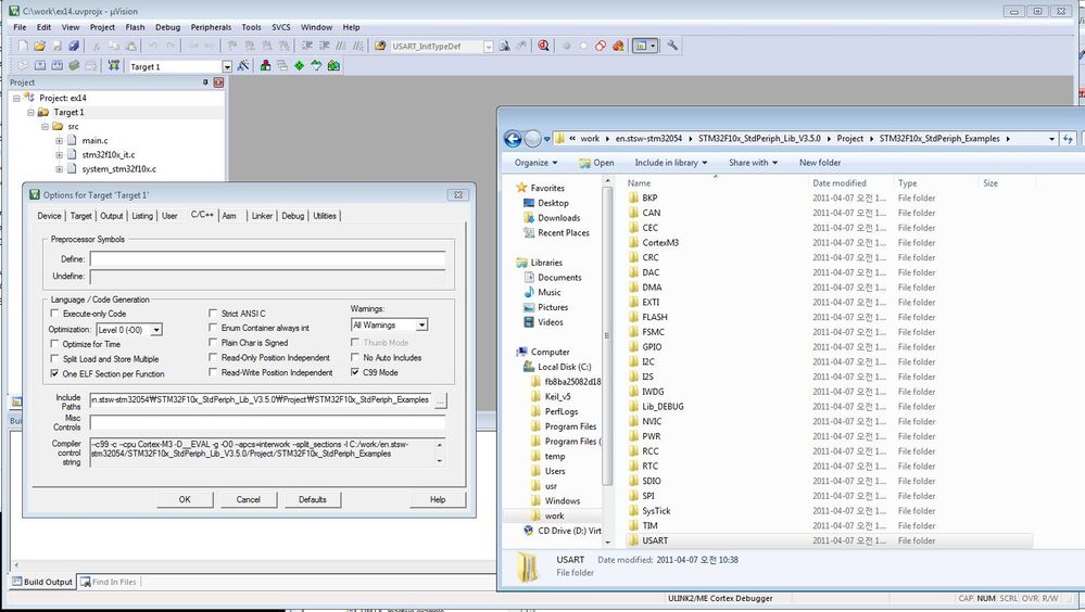

Currently I'm struggling with building up the project with SPL library in Keil.
For example, I'd like to use USART's Interrupt example.
C:\work\en.stsw-stm32054\STM32F10x_StdPeriph_Lib_V3.5.0\Project\STM32F10x_StdPeriph_Examples\USART\Interrupt
and I add codes and set up the include directory.
But I got still error messages what there is missing define.
Could you please how to resolve this problem?
and I've attached project file. ex14.7z

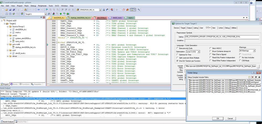

Thanks Clive, But I'm still struggling with build up the project even I refer the template project.
the error message is the below
can you help me what am I supposed to do?
*** Using Compiler 'V5.06 update 5 (build 528)', folder: 'C:\Keil_v5\ARM\ARMCC\Bin'
