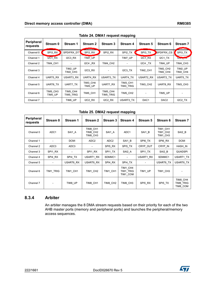

You can't pull DMA channel/stream numbers out of thin air, the DMA triggers in 'F7 are hardwired and Cube/HAL can't magically reassign them.
2019-06-27 10:16 PM
2019-06-28 12:39 AM
It works! I had missed that.
