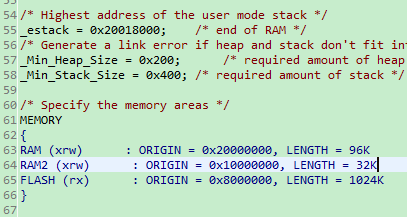

This is toolchain-specific.
For gcc and suite I concocted an example here
http://efton.sk/STM32/blinky_ram2.zip
:- in linker script, RAM2 memory area added and an output section named .ram2 directed to it
- note, that all variables placed in .ram2 are initialized to zero, see FillZeroRam2 in startupxxx.s- in .c, variables to be placed in .ram have to have __attribute__((section('.ram2'))) added to their definition, see delayN- when generating .bin (or .hex) using objcopy, .ram2 has to be excluded explicitly using --remove-section (or -R) optionJW
2017-01-14 10:36 AM
In case of IAR, a #pragma enables a section of C code to allocate variables to be placed in the 32kb. It is similar to the CCM memory for F4. To keep the code clean there should be options in linker file of the toolchain to put the stack area in the RAM2, reducing the #pragmas in the source code...
