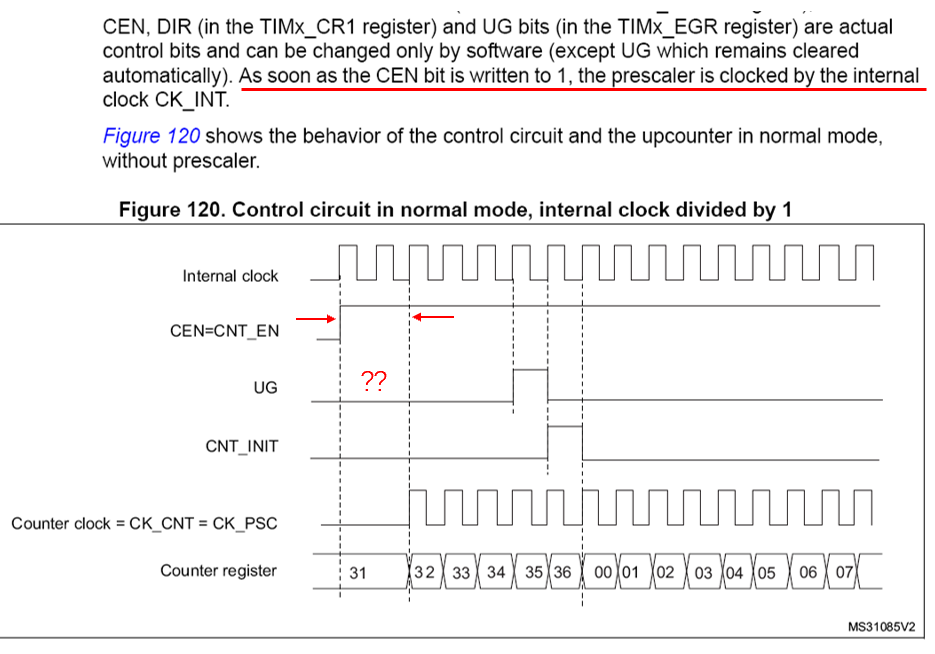

2020-03-20 7:56 PM
Hi, Vincent,
I just posted a post asking for the same question. Then got member told me this was discussed last year. So I searched in the forum and came to this post.
Just to clarify, in that case, for the statement "Note that the actual counter enable signal CNT_EN is set 1 clock cycle after CEN" it is still valid, is it?
From CEN to CNT_EN there is 1 clock cycle, then due to prescalor is 0, the CK_CNT is the same frequency as the CK_INT. But for CK_CNT, the clock appears 1 prescaled cycle after the CNT_EN. That explains the 2 clock cycles here in the Figure 120 (The figure is from RM0008 Reference Manual). Is that right?
Also, another stupid question, CEN, DIR and UG are bits in different registers. Then what about CK_INIT, CNT_EN, what are these signals?
2020-03-22 4:38 AM
Hi, Mirek,
I also came to this problem in RM0008 manual (released in Dec 2018 comparing to Mar 2018 of the one you used), which leads me to your post by searching online.
This is my understanding version of this problem. It says "Note that the actual counter enable signal CNT_EN is set 1 clock cycle after CEN"
So CNT_EN should be 1 clock cycle after CEN bit. Meanwhile, it seems that from CNT_EN, the count will start counting from the original value in the counter register, so the CK_CNT will start 1 prescaled cycle from the CNT_EN trigger.
Therefore, when PSC=00, it shows as 2 clock cycles from CEN to CK_CNT.
When PSC=03 as you set in your 2nd figure, I think that is wrong. The frequency is divided by (PSC+1). So if PSC=03, then the CK_CNT frequency should be divided by 4 (your one is divided by 3). I suppose that is wrong. And based on my aforementioned understanding, from CEN to CNT_EN 1 clock cycle, then to CK_CNT first rising edge should be 1+(PSC+1)=5 clock cycles, which is correct in your case.
