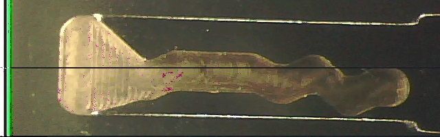

But, there are a problem. i dont removed black line in the middle of the Picture.
From my (rather feeble) knowledge of your project/code, it could well be a bug in how you 'stitch' the parts of the image together.Black end White is a good idea. But as far as I know, camera does not support grayscale.
it supports just; YUV, RGB and RAW.
You can do a ''BW_Intensity = (Red + Green + Blue) / 3'' for each pixel on the fly, before storing it to the RAM buffer. As dave suggested, that would reduce your RAM footprint significantly - if you can live with BW pictures.

Thanks a lot fm for everythings.

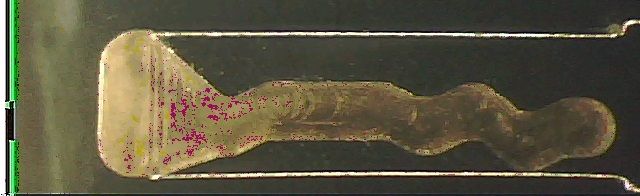

My black line problem in the middle of the Picture is solved with your suggestion. Now, only there is a problem. there are a lotpink
blot in the my picture. How can I solve this problem.2013-09-30 8:45 AM
The green stuff at the edge suggests you don't have the framing/timing right. Front/Back porch?
The pink stuff is more indicative that the colour bit assignments are wrong or misaligned bit stream. ie an issue extracting/decoding the RGB or YUV Is the picture from a milling machine? Cut metal path?2013-10-01 3:52 AM

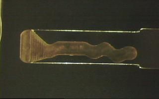

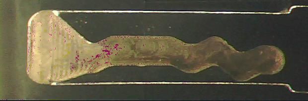

I solved the green stuff at the edge.
there are not pink stuff at the Picture when Picture was QVGA (320*240).But, there are pink stuff at the Picture when Picture was VGA (640*480). As follow :
