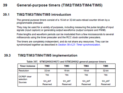

From RM0481:
2023-12-14 12:16 AM
From RM0481:

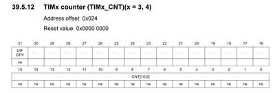

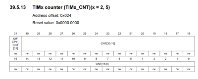

tim2 + 5 are 32 bit:
tim 3 + 4 are 16 bit:

Was an answer to @AScha.3 regarding the FMAC RAM size. And there is no issue in our documentations regarding Timers. As shown in the reference manual in "TIM2/TIM3/TIM4/TIM5 introduction" section, it was said "16-bit or 32-bit". So there are two 16-bit timers and two 32-bit timers as shown in Table 397.
The best answer for your request is the first one I've already provided.
Thank you.

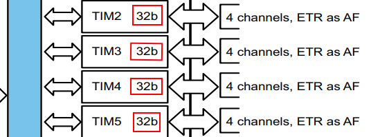

I'm talking about this:
As mentioned, "Figure 1. STM32H573xx block diagram".
Sorry for any inconvenience.
2023-12-15 7:05 AM
OK. Now it's clear. It will be fixed in coming revisions of the DS. It will be treated in the same ticket number: 168793.
