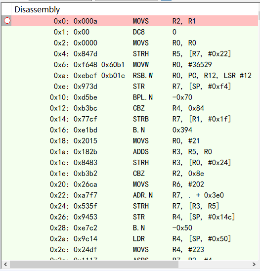

i want to know how the PC run to startup.s when mcu reset?
The Definitive Guide to the ARM Cortex-M3 says address 0x00000000 is MSP‘,address 0x00000004 is ResetVector.
But when I look at STM32F767, I find that 0x00000000 and 0x4 addresses are other instructions
Is there any reference material that can solve my confusion?

So what 32-bit words do you actually see when you inspect the memory?
What words at 0x08000000 ?
2019-01-13 10:57 PM
This is the instructions in 0x0.
At 0x8000000 is vector table.
2019-01-14 5:01 AM
Shouldn't be instructions.
Suspect you don't have BOOT pins configured correctly.
