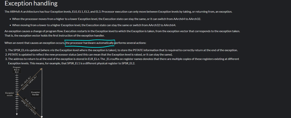

I know controllers push data to stack, PC to LR, etc. but how does this happens? Is it through software or hardware?
If through software then where is the code which does this? and where does it come from? is it the compiler which adds it?
If it is through hardware then how does it happen?
2022-06-07 12:10 AM
https://developer.arm.com/documentation/100933/0100/Synchronous-and-asynchronous-exceptions
2022-06-07 12:10 AM

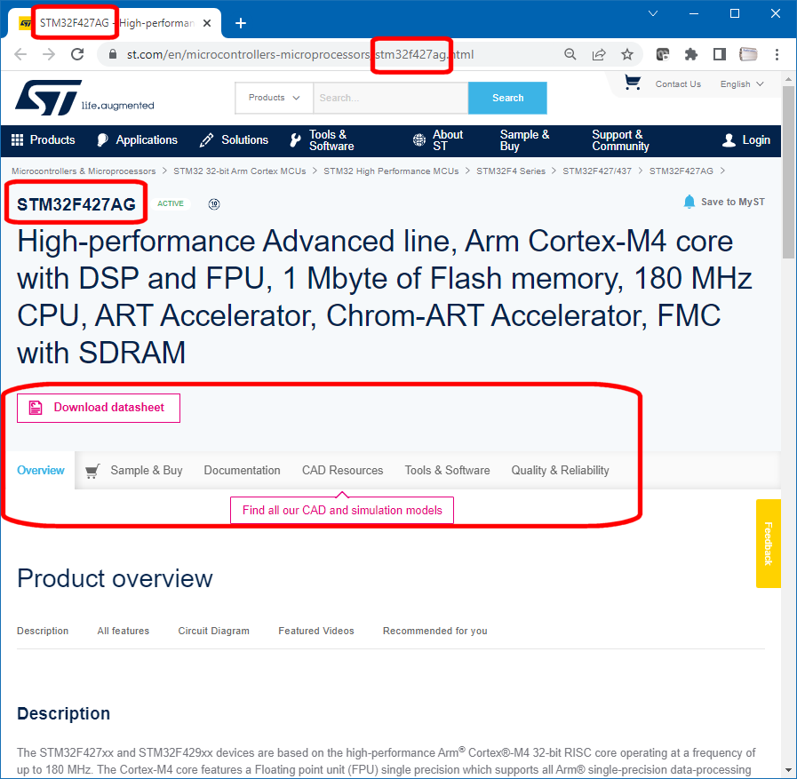

For ST, that will all be accessible via the Product Page for the chip in question; eg,
Most (all?) other manufacturers follow a similar scheme
