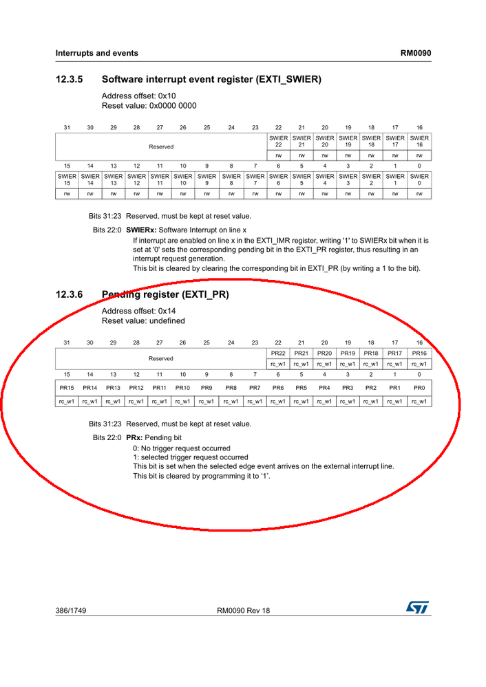

They should flag individually, and OR together to generate the IRQ
Check EXTI->PR register (on F4 for example)

Thanks for the info! That's exactly what I was looking for.
