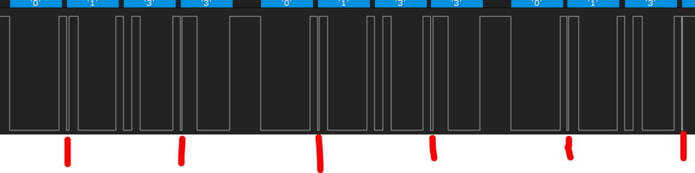

Hello STM32-Community,
I've changed my GPIO speed to "Very Fast", the highest speed available. 1 MBaud seemed to work fine, while everything beyond, e.g. 1.5MBaud did not work properly:
0693W00000HofdCQAR.pngAny ideas how to resolve this?
Kind regards

That signal plot is not okay. The start bit is much too short on most or all of the bytes. It's especially apparent when the LSB is 1. It would be nice to see the time scale for these. Is this from 1.5 MBaud or 1MBaud? What is the code that generates this signal?

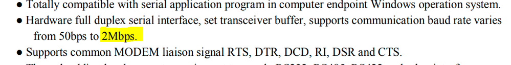

A quick glance suggests the CH340 only works up to 2MBaud per the datasheet. Doesn't explain the issues at 1.5, of course.
0693W00000Hom4EQAR.pnghttps://cdn.sparkfun.com/datasheets/Dev/Arduino/Other/CH340DS1.PDF
I checked the specifications stated ont he website where I purchased them and it stated a 6 MBaud upper limit, though I suppose the data sheet is more correct.

The image is from the 1.5 MBaud analyzing.
