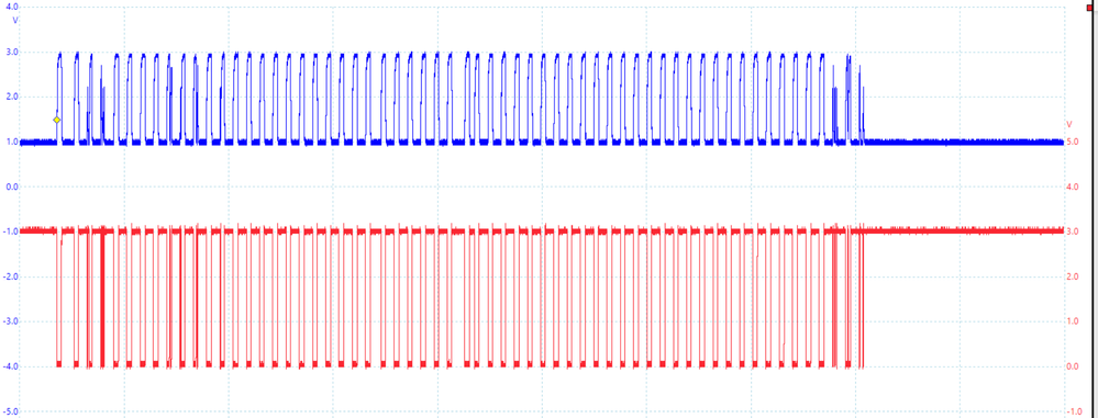

The moment I initialize UART, more specific, when the "transmitter enable" bit USART_CR1->TE the voltage at PA8 drops from 3 V to 1 V. When UART communication is started, the UART_Tx message is visible on the net of PA8. The blue signal is PA8 and the red signal is UART_Tx.
The GPIO configuration of PA8 does not change while UART is configured. It still works as input. When I connect the net directly to 3 V, it shows a '1' in the GPIO input register.
Since PA8 goes to 1 V when UART_Tx is high, it is not a resistive coupling from the PCB (then the signals would be in phase).

The hall sensor seems not to be the problem. I disconnected it from the MCU (there was a 0R on the net to the MCU) and activated the pull-up of PA8. The effect is the same. I see the UART_Tx signal on PA8, though the DC voltage is now 0.36 V instead of 1 V
