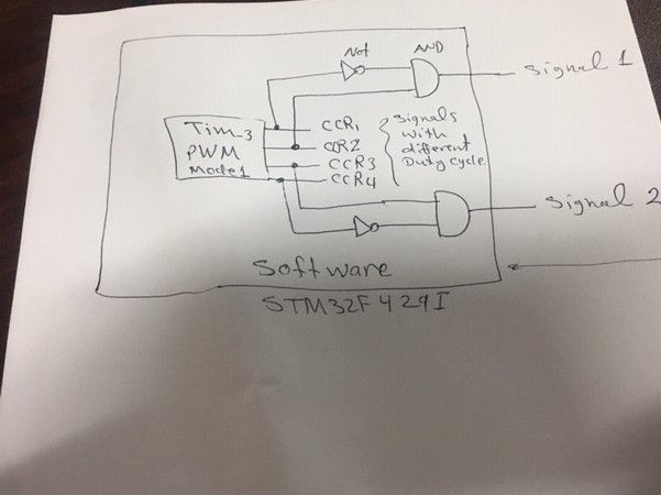

2020-07-02 7:06 AM
Thanks for your replays , but Here in this picture, you can find what I want .
So, is that possible to represent NOT and AND gates by Software instead of HW.
Thanks
I will hear from you
2020-07-02 7:35 AM
Why trying to do an "AND"? just generate 2 waveforms using DMA on channel toggle in circular pattern with table length adjust...
There is no smartio, so integrate the burst of pulses in the generation to each channel.
