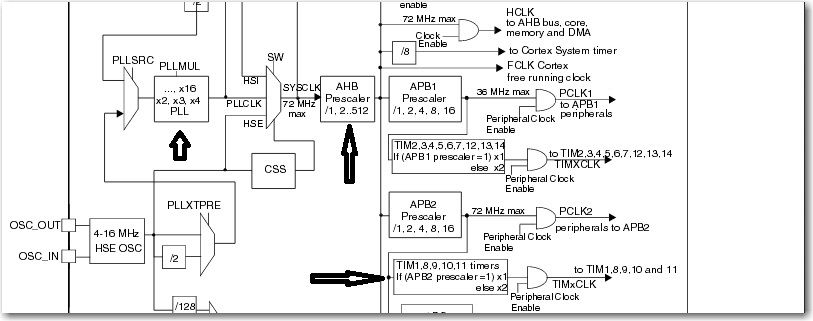

2014-02-10 3:49 PM
my crystal is 8 MHz...does it matter for the timer clock setting ?

2014-02-10 5:36 PM
None of them....This is an up hill battle.
The TIMCLK is going to depend on your PLL/AHB/APB settings. Check what you have in your system_stm32f1xx.c file, and then refer to the Clock Tree diagram in the RM0008 Reference Manual. Going to presume you're not running your STM32F107 at 8 MHz, I'd expect the SystemCoreClock to be 72000000, and the PLL set to get you to 72 MHz. If you're doing something else, then please describe. The TIMCLK is divided down by the values prescribed in the Prescaler and Period values programmed into the timer.2014-02-11 5:15 PM

2014-02-11 7:16 PM
To reiterate, for the clock setting being used you need to examine SYSTEM_STM32F1XX.C, the SystemInit() routine should be called by the start up code prior to your main() routine.
The PRESCALER and PERIOD are numbers that DIVIDE down the TIMCLK ie CLKOUT = TIMCLK / (PRESCALER * PERIOD) WhereTIM_TimeBaseStructure.TIM_Prescaler = PRESCALER - 1;
TIM_TimeBaseStructure.TIM_Period = PERIOD - 1;
In order to get a desired output frequency we have to FACTOR the numbers in a manner to achieve that.
