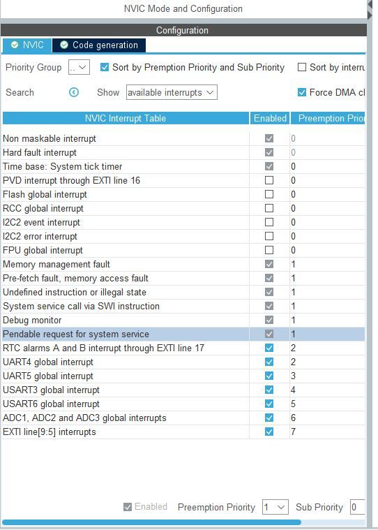

With the code in the infinite loop of the main function, without interruption, the writes in the flash are effective.0693W00000GXDoJQAX.jpgLike the image above, increasing the level of preemption of "Time base: System tick timer" has no effect.
So, how to allow Systick to be incremented when other interruptions are active ?
Please, would you have suggestion ?
Best regards.
Henri

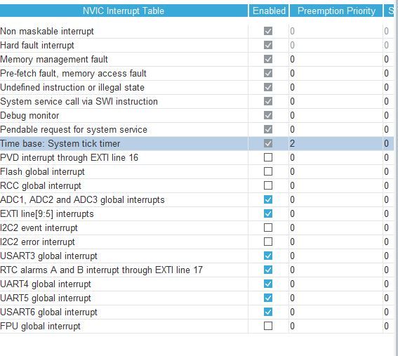

In my reply above, there is a mistake.
The NVIC table, preemption priority, is actualy:
0693W00000GXXx6QAH.jpg"Time base : System tick timer" is now at the highest premption priority.
As I could read somewhere, I put the code (mine) of all ISR in RAM (why not), specialy "Time base : System tick timer".
The problem persists.
