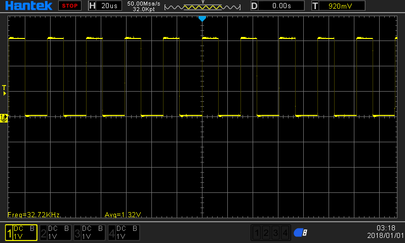

2021-05-24 3:49 AM
@Hi Tesla,
I attached scope image of PA8 output, but signal is in square wave and F= 32.72khz coming instead of 32.768khz.
Need some more changes required for exact clock 32.768khz ?
