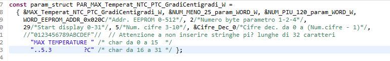

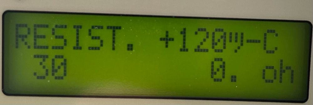

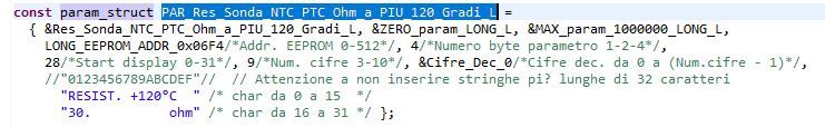

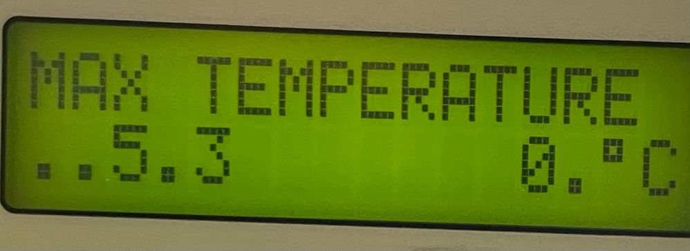

Hi Peter,
with the following code variation I've the symbol "°" in the display. I don't know why I can't write == '°' and leave "°C" instead of =='?' and " ?C". If I do so the if condition is skipped.

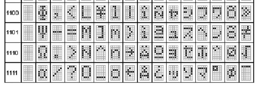

Well, you have not yet inserted the character set of your two-line LCD here. As a rule, the character set only partially matches that in operating systems such as Windows, Linux or MacOS, mostly only in the ASCII range 0x20 (space)...0x7D (left curly bracket).
However, on many of these LCDs, the question mark is usually coded with 0x3F and the degree sign with 0xDF.
