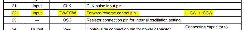

The CW/CCW pin controls direction. Toggle it to change direction.
Configure it as a GPIO output pin, and toggle the output to change direction, as suggested in the first post.
