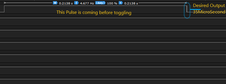

#include<NEW.h>
void delay();
void main()
SystemInit();
RCC->AHB1ENR |=1; /* Enabling clock for GPIOA port*/
GPIOA->MODER |=1<<24;/*General Purpose output function in PA12 Port*/
GPIOA->OSPEEDR|=1<<24;/*Medium speed */
GPIOA->ODR |=(1<<12);/* Turning ON PA12pin */
delay();/* 35 microseconds ON*/
GPIOA->ODR &=~(1<<12);/* Turning OFF PA12 pin */
while(1);
void delay()
RCC->APB1ENR |=1<<0; /* TIM2 clock enabled*/
TIM2->CNT=0;
TIM2->ARR=500;
TIM2->PSC=1;
TIM2->CR1 |=1;
while((!TIM2->SR & 1<<0));
TIM2->SR=0;
2021-04-20 3:43 PM
Pulled-up the otherwise floating pin? Maybe your LA pulls it up?
Do you use the embedded bootloader?
Try some other pin. Try a 1kOhm pulldown.

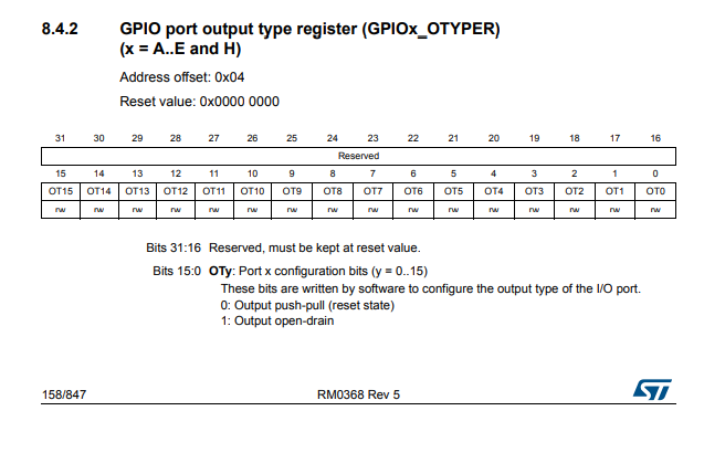

Problem Solved after Connecting 1 Kohm Pull Down Resistor .
But output Pin is selected as Push-Pull(reset state) in GPIO_OTYPER by default. Why Pin is Floating i don't Understand.
Thank you for ur Extended Support .
2021-04-21 8:59 AM
After reset, almost all pins including PA12 are set as Input in GPIO_MODER.
GPIO_OTYPER setting is pertinent only when the pin is turned to output, i.e. either set as Output in GPIO_MODER; or set as AF in GPIO_MODER and the controlling peripheral selected by GPIO_AFR set it as output (for example as when timer channel is set to Output Compare).
