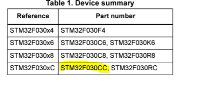

I am using custom board with controller with part number given below
2022-07-27 10:29 PM
as i am using stm32f030cct6 in my custom board, in this two controllers are used with same part number.
