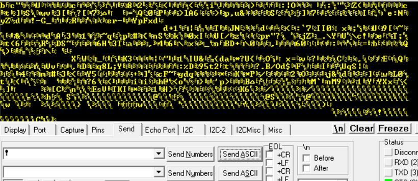

Lot of mixed methods there. Decide if you're using callbacks, or not, then stop calling the HAL IRQ Handler if you're going to service the UART directly.
Can you output data in a normal polled method, and does that look good? If not check the HSE_VALUE is consistent with 8 MHz clock on the board.
2021-03-12 11:16 PM
Only receive is started in main. You'll need an interrupt before anything's transmitted. The interrupt may be receive, or any other interrupt enabled by HAL_UART_Receive_IT
Your USART1_IRQHandler calls HAL_UART_IRQHandler, which checks the interrupt status register to determine what conditions it needs to service. You should register callbacks that HAL_UART_IRQHandler will call for the conditions you care about.
Your interrupt code wouldn't work correctly anyway as the UART_IT_RXNE and UART_IT_TXE macros can never equal the RESET macro and so it'd be calling HAL_UART_Receive_IT and HAL_UART_Transmit_IT spuriously.
Your loop at the bottom of main keeps the transmit buffer full. If the strange characters are in "abcdefxxxxxxxxxx" that'll be part why.
2021-03-15 5:07 PM
So what should I write instead of this "if(UART_IT_RXNE !=RESET){" and this " if(UART_IT_TXE !=RESET){" ???
when I add in while this :
________________________________
While(1)
char downloaded;
uart_get_char(&downloaded);
if(downloaded == '!' ){
uart_put_string("abcdefxxxxxxxxxx");
_____________________________________
I send twenty times '!' (because my buf has 20 size and then I received this(picture below). When I removed this:
//void USART1_IRQHandler( void ) {
//HAL_UART_IRQHandler(&huart1);
and insert this:
void HAL_UART_RxCpltCallback(UART_HandleTypeDef *huart) {
nothing was displayed.
