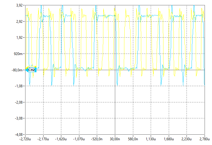

2021-04-22 9:57 AM
The Signal does not look unusual. Could it be, that i use the wrong clock strobe? I only got one microphone.
