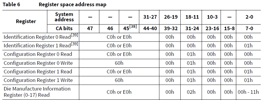

  • In order to write to a configuration register of the RAM you need to set sHyperBusCfg.WriteZeroLatency = HAL_OSPI_NO_LATENCY_ON_WRITE
  • In order to write to a configuration register of the RAM you need to set sCommand.DQSMode = HAL_OSPI_DQS_DISABLE
  • Register address from the HyperRAM datasheet has to be multiplied by 2, NbData needs to be 2 bytes.

l solved at least one issue: I figured out how to write to the configuration register of the HYPERRAM:
typedef union
	uint16_t reg;
	struct
		unsigned int burstLength:2;
		bool hybridBurstEnable:1;
		bool fixedLatencyEnable:1;
		unsigned int initialLatency:4;
		unsigned int reserved:4;
		unsigned int driveStrength:3;
		bool deepPowerDownEnable:1;
}CR0_t;
#if 1
 ///write to CR0
  volatile CR0_t CR0_new = {  .burstLength = 3,
		  	  	  	  	  	  .hybridBurstEnable = true,
							  .fixedLatencyEnable = true,
							  .initialLatency = 15, // 1111 - 4 Clock latency @ 104 MHz Max frequency
							  .reserved = 15,
							  .driveStrength = 3, // 011 - 46 ohm
							  .deepPowerDownEnable = true};
  sHyperBusCfg.WriteZeroLatency = HAL_OSPI_NO_LATENCY_ON_WRITE;
  if (HAL_OSPI_HyperbusCfg(&hospi2, &sHyperBusCfg, HAL_OSPI_TIMEOUT_DEFAULT_VALUE) != HAL_OK)
    Error_Handler();
  sCommand.DQSMode      = HAL_OSPI_DQS_DISABLE;
  sCommand.Address      = 0x800*2; //CR0
  sCommand.NbData       = 2;
  if (HAL_OSPI_HyperbusCmd(&hospi2, &sCommand, HAL_OSPI_TIMEOUT_DEFAULT_VALUE) != HAL_OK)
    Error_Handler();
  status = HAL_OSPI_Transmit(&hospi2, (uint8_t*)&CR0_new, HAL_OSPI_TIMEOUT_DEFAULT_VALUE);
  sHyperBusCfg.RWRecoveryTime = 4;
  sHyperBusCfg.AccessTime = 4;
  sHyperBusCfg.WriteZeroLatency = HAL_OSPI_LATENCY_ON_WRITE;
    Error_Handler();
#endif
Now I get higher bandwidth and matched impedance, but I still see tearing.
