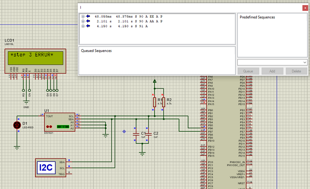

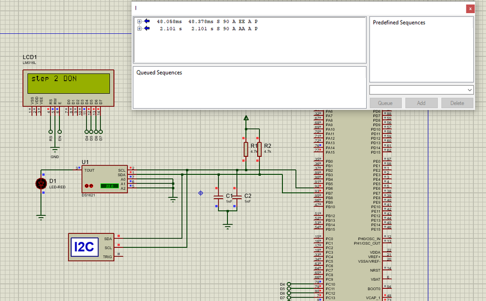

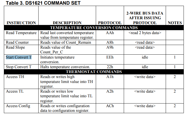

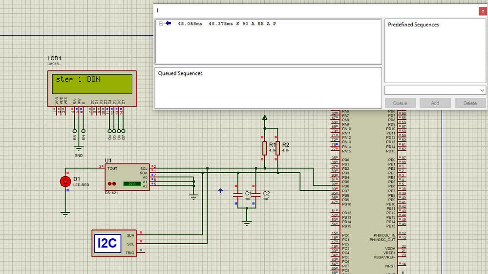

hello i'm trying to make a project whit stm32f401ve and Digital Thermometer DS1621 using I2C protocol, and I have a problem whit i2c receive. here is my source code and photos of datasheet and simulation any help will be appreciated
SEKLAMIN
Associate II
static const uint16_t TEMP_ADRESS = 0x48<<1;
int main(void)
HAL_StatusTypeDef RETURN ;
uint8_t buffer[1];
uint8_t buffer2[2];
uint16_t Val ;
float temp_c ;
  HAL_Init();
  SystemClock_Config();
  MX_GPIO_Init();
  MX_I2C1_Init();
 buffer[0]=0xEE;
 RETURN=  HAL_I2C_Master_Transmit(&hi2c1, TEMP_ADRESS, buffer, 1,  HAL_MAX_DELAY);
               if(RETURN!=HAL_OK)
                   Lcd_cursor(&lcd, 0,0);
                   Lcd_string(&lcd, "step 1  ERUUR");
                   HAL_Delay (2000);
                  else
                   Lcd_string(&lcd, "step 1 DON ");
                   HAL_Delay (2000);
                   Lcd_clear(&lcd);
while (1)
  buffer[0]=0xAA;
  RETURN = HAL_I2C_Master_Transmit(&hi2c1, TEMP_ADRESS, buffer, 1,  HAL_MAX_DELAY);
           if(RETURN != HAL_OK)
             Lcd_string(&lcd, "* step 2 ERRUR*");
             HAL_Delay (2000);
             Lcd_clear(&lcd);
           else
             Lcd_string(&lcd, "step 2 DON");
             HAL_Delay (2000);
             Lcd_clear(&lcd);
RETURN =  HAL_I2C_Master_Receive(&hi2c1, TEMP_ADRESS,buffer2, 2, 10000);
                   Lcd_string(&lcd, "*step 3 ERRUR*");
                   HAL_Delay (2000);
                   Lcd_clear(&lcd);
                 else
                   Lcd_string(&lcd, " step 3 DON");
                   HAL_Delay (2000);
                   Lcd_clear(&lcd);
Val = ((int16_t)buffer2[0]<<4) | (buffer2[1]>>4);
                               if(Val>0x7FF)
                                 Val|=0xF000;
                               temp_c= Val*0.0625;
                               temp_c*=100;
  sprintf((char*)buffer2,"Temp = %u.%u",((unsigned int)temp_c/100),((unsigned int)temp_c% 100));
                               Lcd_string(&lcd, buffer2);
                               HAL_Delay (2000);
                               Lcd_clear(&lcd);
