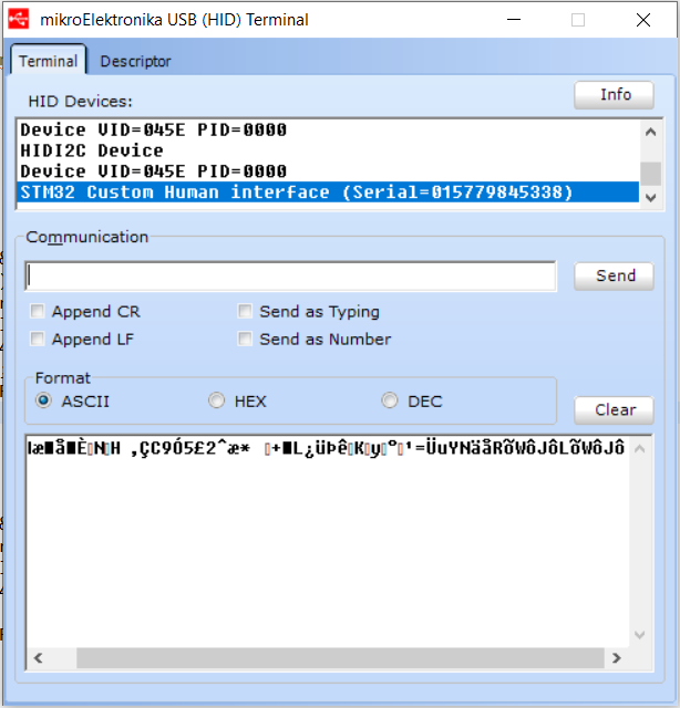

2022-03-28 11:28 PM
Namely, before, I could easily read from 1 channel adc and drive the LED with PWM signal. But when I want to drive more than one LED with multi-channel, there is a problem. I want to read ADC on PA4 and PA5 pins and output from PA0 and PA1 pins. My Prescalar value is 0 and my counter period value is 65535. I have never played with these values.You can see the data coming to the HID terminal below.
