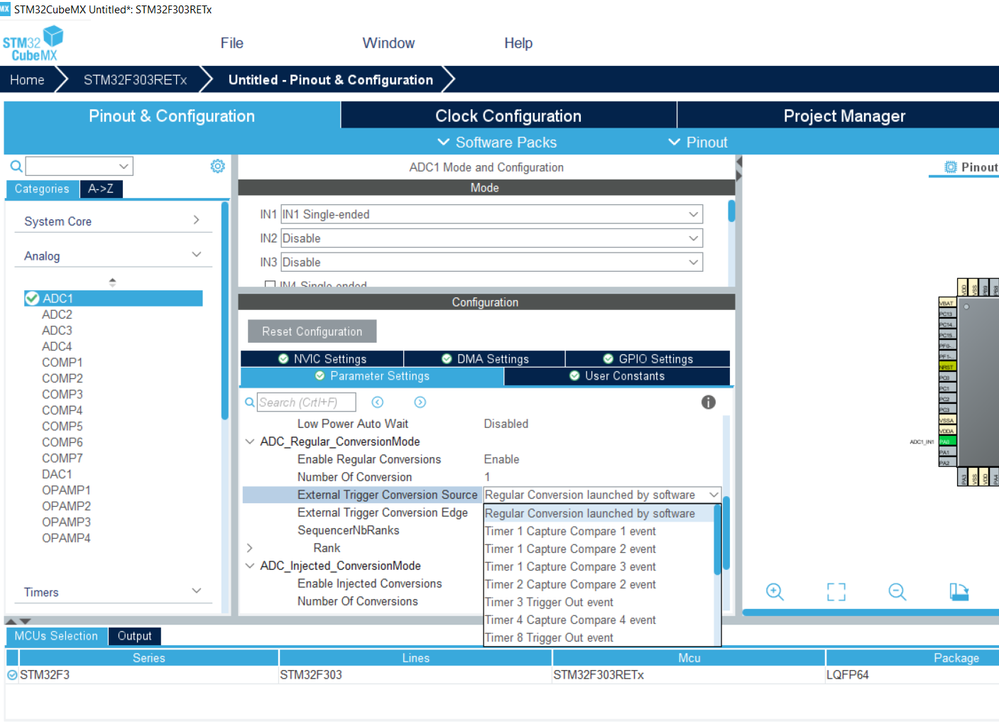

Yes it is.
In CubeMX you can see what external triggers could the ADC have.
Im sure there is a better way to address your problem but you could trigger the ADC with a "Regular Conversion Launched by software" inside your EXTINT callback
Then you can just configure the DMA to take care of the ADC readings as they come

Yes it is.

Thank you very much @Javier Muñoz . I will try this out
