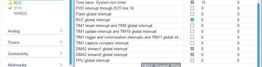

Actually I require the callback function is whenever complete the full arrray throgh DMA , DMA will trigger the TCIF flag .SO then i require a user defind callback .so I registred a call back function as follows
HAL_DMA_RegisterCallback(DMA_HandleTypeDef *hdma, HAL_DMA_CallbackIDTypeDef CallbackID, void (* pCallback)(DMA_HandleTypeDef *_hdma))
HAL_StatusTypeDef status = HAL_OK;
/* Process locked */
__HAL_LOCK(hdma);
if(HAL_DMA_STATE_READY == hdma->State)
switch (CallbackID)
case HAL_DMA_XFER_CPLT_CB_ID:
hdma->XferCpltCallback = pCallback; // it will trigger or give 1 , upon the full transfer
break; //
HAL_DMA_RegisterCallback(&hdma_tim1_ch1,aCallbackIDTypeDef,Usrdefnd_Complete_callback);
void Usrdefnd_Complete_callback(DMA_HandleTypeDef*hdma)
HAL_GPIO_WritePin(GPIOA, GPIO_PIN_5, GPIO_PIN_SET);
I tried like wise but not worked .
Also I tried the follwsing type of callback
hdma.XferCpltCallback = MyDMA_TransferCompleteCallback;  //But not worked as expected
I doubt as follows
HAL_TIM_PWM_Start_DMA(&htim1, TIM_CHANNEL_1, (uint32_t *)sin_table, 20);//low
HAL_TIMEx_PWMN_Start_IT(&htim1, TIM_CHANNEL_1);
Here I am not used IT in the HAL_TIM_PWM_Start_DMA funtion , is it make any problem ?
anyway the cube ide enabled the DMA2 stream 1 and 2 as shown below .
