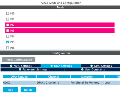

Here is what my ADC1 configuration page looks like with the available "DMA Settings" tab.

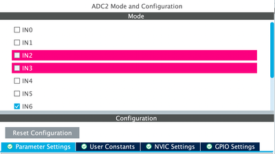

Here is what my ADC2 configuration page looks like without the available "DMA Settings" tab.

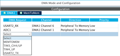

Here is what my DMA configuration page looks like without the option to add a DMA request for ADC2.

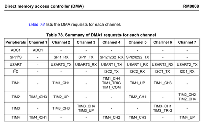

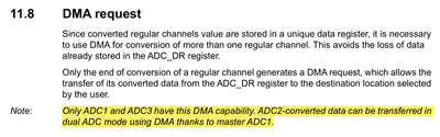

ADC2 doesn't have a DMA trigger, only ADC1.
Might be able to set it up in dual mode to get this data out.
