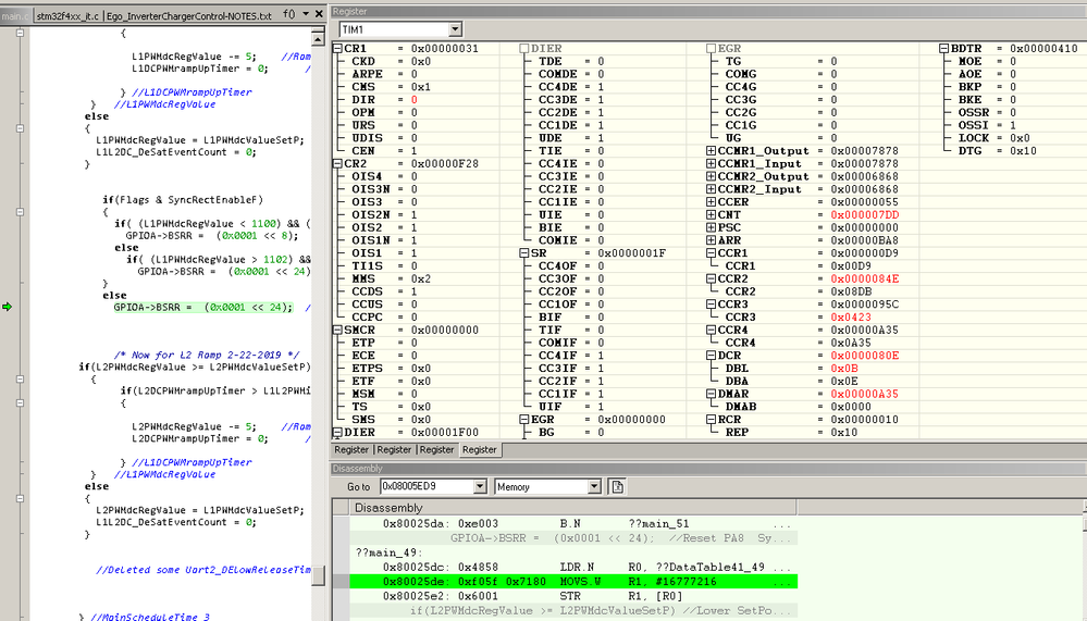

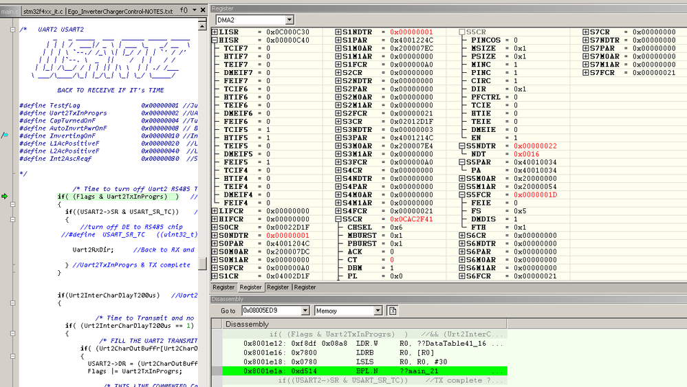

There are several things I could upload but a couple of debug captures of registers might be useful to add to my ********...
EDIT: JUST noticed I am getting some DMA2 Stream 5 error flags. THAT will disable my stream... BUT should not have any effect on the TIM1 MOE output enable bit as far as I can see with the documentation.
The DMA2 Stream 5 registers expanded ... Not my end DMA mode necessarily, just some of what I am getting.
The Timer 1 registers after a typical DMA trigger.
To get the red updated numbers, I have to hit F5 again but that's OK.

But the main problem is, that you use increment on the peripheral side, it means, that you write the first transfer into the DMAR register, but each subsequent writes go further and further up in the TIM registers area, until it overwrites the register containing MOE.
Note what have I said on viewing the pointer registers in DMA in my previous post.
