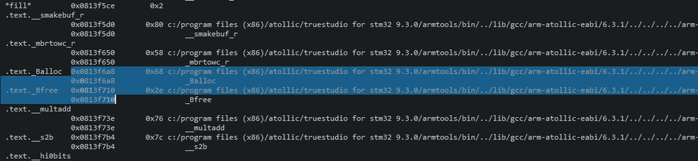

thank you for you comments. The fault fall between Balloc and Bfree functions (see picture)
I'm using FreeRTOS with #define configUSE_NEWLIB_REENTRANT 0 because I'm using C standar library (no newlib). Analyzing the Call Stack, what I undertand is the standard C library is using reentrant functions since the most of them have the "_r" ending.
0x0813DC89 - _dtoa_r (Where the fault is triggered)
0x0813F702 - _Balloc
0x0813FD27 - __2db
0x081404D3 - __ssprint_r
0x0813A6B5 - __ssvfscanf_r
Do you suggest use any alternative to format float values without using the standar library?
