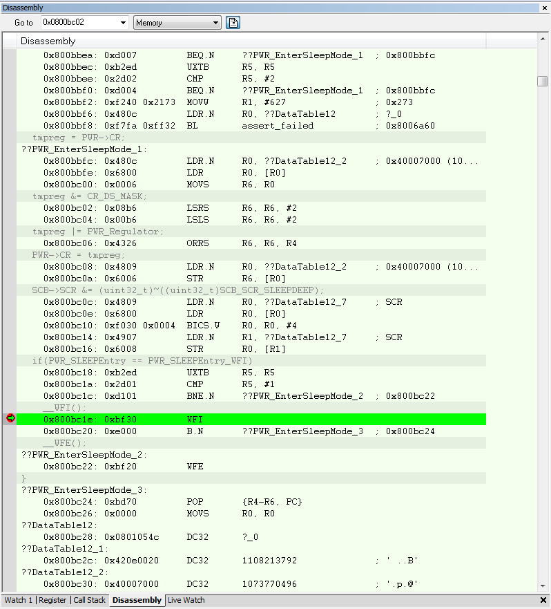

Migrating the code though, has started triggering HARDfaults with the Invalid state flag set in the CFSR. It just so happens when calling the _WFI() instruction to go to sleep.
(using IAR 7.10.3). The problemdisappears if I put a breakpoint before or on the WFI operation ( see addr 0x800bc1e in disassembly dump ). The problem occurs again in a different location if I modify the code and the binary moves around.

I did try the synchronasitation_DSB();__ISB(); but the problem did not disappear.I have been focusing on the occurring interrupts as suggested, but I am still puzzled why I am seeing what I am seeing.This is an interrupt log of my project showing hard fault occurring straight after entering TIM10 ISR.2015-02-19 10:31 AM
