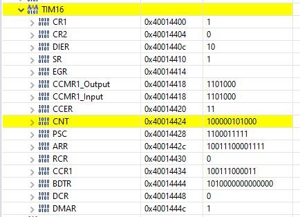

P.S. Here is a TIM16 register dump

HAL_TIM_PWM_PulseFinishedCallback is called when the pulse value (CC1) is reached, so that's the one you want.
HAL_TIM_PeriodElapsedCallback is called when the timer updates. It is enabled with HAL_TIM_Base_Start_IT. It sounds like you may want this one as well?
HAL_TIM_PWM_PulseFinishedHalfCpltCallback is enabled in HAL_TIM_PWM_Sta1rt_DMA and similar and doesn't do what you want here.
