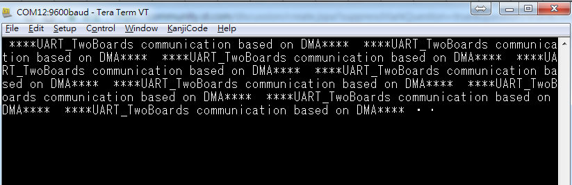

If I add some code ''HAL_UART_Transmit_DMA(&UartHandle, (uint8_t*)aTxBuffer, TXBUFFERSIZE);'' between HAL_UART_Receive_DMA() and
while (UartReady != SET) loop.
It will show messages on my PC terminal, but LD2 still didn't flash.
