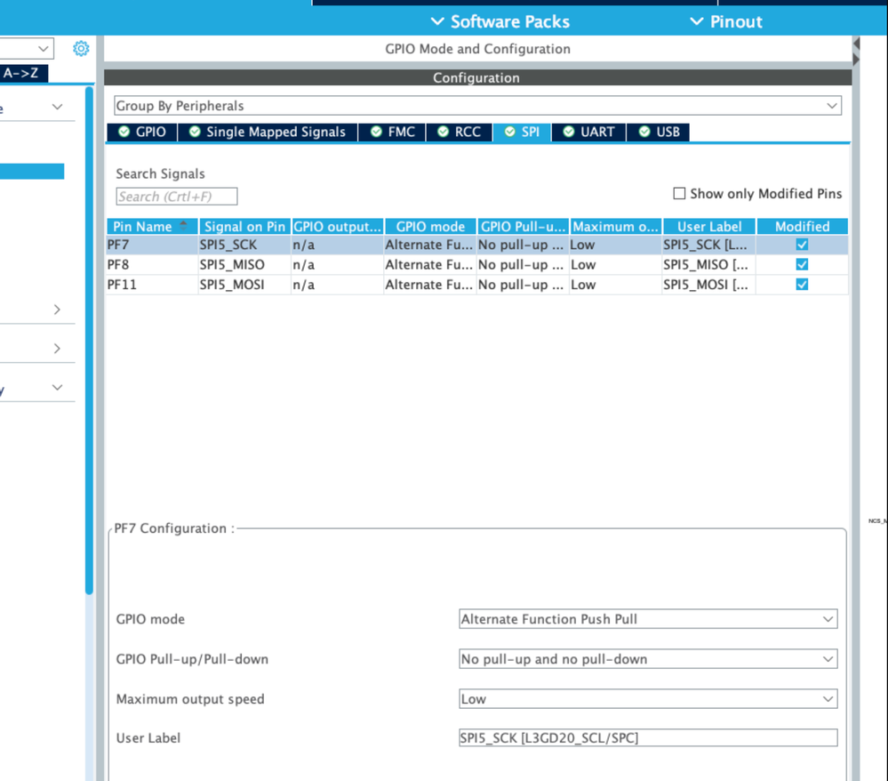

Hello. I am trying to read ReRAM( FUJITSU: MB85AS4MT) by using HAL_SPI_Receive().
But the LSB is recognized as 0 even the reply from ReRAM is returning 1 to LSB.
(ex: '11111111' is recognized as '11111110', or '01010101''' is recognised '01010100' )
As far as I see the signals by the Oscilloscope, ReRAM returns the proper signal. I guess it is an STM32 board side problem. Could someone solve the issue?

2021-05-20 2:20 PM
Maybe the Corrupted last bit of data and/or CRC, received in Master mode with delayed SCK feedback erratum?
How is OSPEEDR set for SPI_SCK pin?

2021-05-25 9:16 AM
Hello JW. Thank you for your reply.
The OSPEEDR set for SPI_SCK pin was "Low" as attached image.
After changing it to "Very High", it works properly. Thank you very much.
