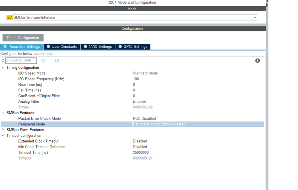

I configured I2C SMBUS in cubemx and reimplement HAL_SMBUS_MasterTxCpltCallback, then I called MX_I2C1_SMBUS_Init() and HAL_SMBUS_Master_Transmit_IT().
After that i had no any events: not called callback and no any data transmited. In fact on sda and scl pins i had only straight lines (saw in oscilloscope). The same hardware configuration but with I2C at least generate clock an data signals. SMBUS config you can see below.

Did you enable the SMBUS (or I2Cx) interrupt in the NVIC peripheral?

if You mean NVIC_settings than yes, i enabled it

Seemed i found the problem. there were troubles with XferOptions
